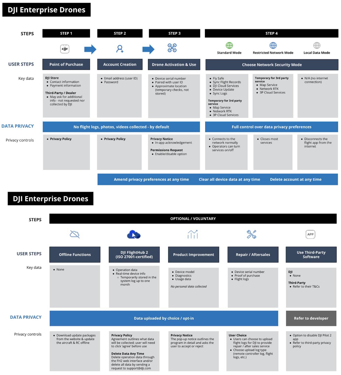

As illustrated by the following images, DJI Pilot 2 provides users with enhanced controls, including network security mode, media data encryption, log one-click deletion, offline firmware update, offline GEO Zone unlocking, and offline map.
NETWORK SECURITY MODES
Operators can choose from a range of network security modes:
1.Standard Mode: App will connect to the network and you can turn a service on or off according to your needs.
2.Restricted Network Mode: The app will close most data services. It will still support maps, network RTK and custom livestream functions.
3.Local Data Mode (LDM): The app will close all data services and will not send any network requests. While in Local Data Mode, it is impossible for a user to sync their data even accidentally with DJI. If you attempt to do so, you will receive the following message:
